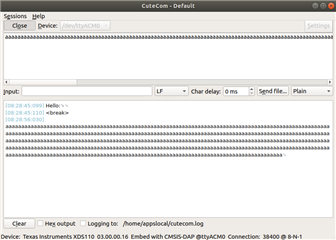

    I tried to reproduce the issue that you are facing, but I couldn’t experience what you are seeing. I tried two different revisions of the CC1310 Launchpad.
    My setup:
    • Ubuntu 18.4
    • CC1310 Launchpad Rev. 1.4 (XDS110 based on TM4C129)
    • CC1310 Launchpad Rev. A (XDS110 based on MSP432)
    • CuteCom (For serial communication monitoring)
    • Saleae Logic analyzer
    To run the tests, I used the modified UART echo example that I shared before. I modified it slightly to add a “Hello” message.
    1. The CC1310 sends a Hello message to the Linux host.
    2. From the Linux host (CuteCom), a single message with a length of 500 bytes is sent to the CC1310 through the XDS110.
    3. The CC1310 reads the message with UART_read() and once the 500 bytes have been received, it echoes back the message in its entirety to the Linux host, where it is visualized with CuteCom.
    4. This means that both Tx and Rx are being tested for long messages.
    All of this while also using the logic analyzer to monitor Tx and Rx.
    Attached you will find a screenshot of the CuteCom output. In the CuteCom screenshot, the upper text box shows the message sent from the host, and the lower text box shows the messages that the Linux host received (i.e. the “hello” message and the echoed message).
    Now, I’m aware that most likely there is a difference between the Linux Kernel you have and the one used in my tests, but I don’t sure if this would have such a strong effect in the results.
    BR,
    Andres
  • Hi Andres,
    thank You for taking the time and trying to reproduce the reported issue. You mentioned cutecom. I tried that application and it suddenly worked. Before, I was only testing on command line and outputted values using cat and command-line based terminal applications.
    That indicates that the problem is on the host side. Either in the Linux kernel driver or even just in the port configuration.
