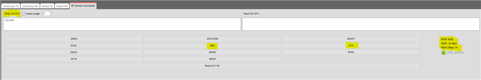

    • Make a small test program where you do the following:
    • Init MCU
    • Init radio with the settings above
    • Write a packet to the TX FIFO
    • Strobe SRX to enter RX Mode (you can here poll marcstate to make sure that the radio has had time to enter RX before you strobe STX)
    • Strobe STX to transmit the packet
    If the channel is available the packet will be sent and the radio will enter IDLE state
    If the channel is BUSY, the radio will remain in RX.
    The test above is what you need to start testing, to verify that your CS Threshold is set correctly.
    Once you have verified that this works (it can even be tested with SmartRF Studio as I explained in the first post), you need to start debug your application to figure out why it does not work.
    To debug this it is useful to output the LNA and PA signals to some GDO pins to figure out when your devices are in RX and TX, to better understand what goes wrong.

    I'll check with Smart RF Studio (I'll connect CC debugger to CC1101) with above setting. After that I'll post an update.
    For this i use GDO_CFG = 0x09(Clear channel assessment) or 0x0E(Carrier sense)
