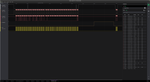

1. We are producing working devices using MSP430FW423/MSP430FW425 and cc115l as radio transmitter.
2. We are using configuration form RFStudio with default values for "100kb optimized for current consumption". Configuration process is shown on attachment1 and source for saleae logic2 is here: https://www.dropbox.com/s/whc609zdau98lty/34.C.05%20cc%20configuration%20attachement1.sal?dl=0
3. We are sending data and reacting on GDO pin that is setup for 0x06 (Asserts when sync word has been sent, and de-asserts at the end of the packet. The pin will de-assert if the TX FIFO underflows.) This is shown in attachement2 (https://www.dropbox.com/s/8cfund2a2snh4j3/34.C.05%20cc%20normal%20send%20attachement2.sal?dl=0)
4. Now for our latest production we have problem with fifo underflow error randomly showing when trying to send frame. See attachement 3 (https://www.dropbox.com/s/784a0py70dfkn2u/34.C.05%20cc%20send%20with%20underflow%20attachement3.sal?dl=0)
5. right after that frame we try to send next one. We perform fifo flush, which succeded and send data to fifo (status is 0x0F -> OK!!) and when performing STX command we get 0xFE status that indicates clock or voltage error. GDO is not asserted and module stays in TX mode. Carier is enabled and module consumes 35 mA of constant current. see attachement 4 (https://www.dropbox.com/s/vicgmbfnu87butl/34.C.05%20cc%20send%20CHIP_RDYn%201%20attachement4.sal?dl=0)
6. After that we have timeout in master uC and cc115l is reset and reprogrammed again. After reset it works as expected for couple of sends and randomly this problem returns. Sometimes after one minute, sometimes after hour. We Have about 8 errors during 4 hour period on current DUT. We haven't observed this issue on every device for now.
What could cause the problem?
Have you seen something similar on other projects?
What other data we could provide?
What we should test to know cause of this error?
I don't see relation to errata notes here but maye I'm missing something?

  • Hi Siri,
    You have problems with links or you can't install free saleae Logic2 software to view files?
    here are files for direct download:
    www.dropbox.com/.../34.C.05 cc configuration attachement1.sal
    www.dropbox.com/.../34.C.05 cc normal send attachement2.sal
    www.dropbox.com/.../34.C.05 cc send with underflow attachement3.sal
    www.dropbox.com/.../34.C.05 cc send CHIP_RDYn 1 attachement4.sal
    Here you have registers definition from RFstudio. It's default configuration for 100kb optimized for current consumption. Only GPIO2 changed to 0x06.

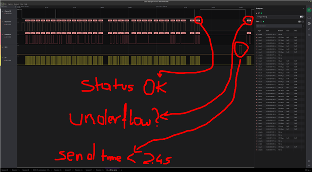

    Number of bytes in fifo is correct. I've checked this. It is visible on provided datagrams. (i'm unable to share code for obvious reasons)
    "CHIP_RDYn not being low when CSn is pulled low, indicates that you have a HW problem."
    1. Hmm... right now we have soldered cc115l from our DUT to another board and problem remains. Only cc115l chip was replaced. Currently we are soldering brand new cc115l to board DUT board. (cross replace). I will keep you informed.
    2. A you can see on datagrams we are filling fifo before executing command STX. During fifo fill status is 0x0f (so everything is correct). than when fifo is filled SC is going high and then low for STX command. HERE status is 0xFE. So CHIP_RDYn = 1. Supply voltage is 3.6V and we have checked on osciloscope that it is good (without any disturbances)
    3. This product is on market for 5 years and we haven't noticed such behaviour before.
     Maciek

    "I assume checking the SPI lines with a logic analyzer will get the same plots as you posted originally. Have you checked the lines with an oscilloscope to check if the logic analyzer gives a correct picture (if the logic levels or the rise/ fall times are off what you see on the analyzer may not be correct compared to how the chip handles the levels. It could be that your design is marginal and that things work for some chips but not others dependent on the VOL/ VOH levels."
    Yes and yes. Scope is showing correct signal levels.
    "When CSn is pulled low, the MCU must wait until CC115L SO pin goes low before starting to transfer the header byte. This indicates that the crystal is running. Unless the chip was in the SLEEP or XOFF states, the SO pin will always go low immediately after taking CSn low."
    True. In first attachement you can see chip configuration.
    In second attachement there is "normal frame send". You can see that right after CS low we have SO hi drived by cc115l. I have small delay between CS low to SO hi. Than I wait until SO goes low.
    Than there is third attachement that shows erroneous behaviour during TX command strobe. You can see that cc115l correctly drive SO hi after CS low and there is correct wait until CS falls down.
    Last attachement, there is a problem you have mentioned. BUT!!! cc115l doesn't drive SO pin hi after my CS low so my wait for SO low procedure finishes immiedetly (SO is actualy low). And yes 0x7F is received from first response byte. But this happens after first error during TX strobe in previous frame.

  • I'm not in the lab today but I have looked at the original Salee plots again to see if something else than timing could cause an issue.
    I see from the plot "cc send with underflow attachement3.sal" that the packet length is different than the first attachment which is a TX that goes without errors. Is it any correlation between packet length and the underflow error?  (in case of a strange stuck at error etc) Also in the case with an underflow error, have you checked what the device actually send in this case?
