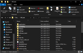

    You're right. I uninstalled using the Windows Uninstaller and the configPkg and src were the only folders left. I deleted and reinstalled the SDK.
    Now my project is very broken in IAR as it's looking for files in this location. I've no idea what's happened but I think you're right about the IAR base project setup. I started with an example Collector project. May be because I compiled the raw project first to check it worked, it has left folders and files in this location. May be I have to start again but not compile the example project at all. Instead, copy all my project parts across and compile only then.
    I still think it might be a Sysconfig problem where the original collector example setup was for a CC1312R Launchpad, which I then changed from in Sysconfig. Besides this, I've no idea what's gone wrong.
    [Su007]: Unable to open the command file "c:/ti/simplelink_cc13xx_cc26xx_sdk_5_30_00_56/source/ti/ti154stack/apps/../../../../source/ti/ti154stack/common/boards/CC13X2_LAUNCHXL/configPkg/compiler.opt.defs" C:\Users\Software3\Documents\cc1312r_868_sdk_5_30_v6\collector\release\Obj\Collector CC13X2\application\collector\link_controller\cllc.o.rsp 1
    I have started again but have ended up with the same folders back in. It's something to do with either IAR when opening the example collector project, or compiling the example code. I will try again and see if I can get a better idea of what's going on. I've got some tight deadlines so this is not a nice problem to have.

  • the configPkg gets produced at the start of a fresh IAR build. I was very careful and created a completely new project and sysconfig file with no board specified at all, I still get the folder outputs:

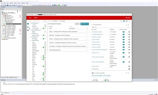

    2) I actually did not realise I could click on the sysconfig file in IAR and it would open Sysconfig. I have always opened Sysconfig separately and open the files directly. Whenever opening a new file it always fails and I would have to add the header lines I mentioned previously. I had to change the Configure Viewer to:
    $SYSCONFIG_ROOT$\nw\nw.exe $SYSCONFIG_ROOT$ --compiler iar -s $SIMPLELINK_CC13XX_CC26XX_SDK_INSTALL_DIR$\.metadata\product.json --output $PROJ_DIR$ $FILE_PATH$
    which worked. Fantastic!
