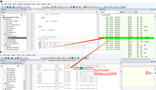

One of my customer is using CC1312R to transfer 100Kbps GI measurement data.
The customer is stuck on from BOOTLOADDER to APP part. Do you mind helping to have a view?

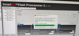

2) I don't understand what they are using SmartRF studio for. I would suggest using either SmartRF studio or embedded code to program the devices. It's not possible to combine these two. For more help on how to use SmartRF studio, please see:
https://dev.ti.com/tirex/explore/node?node=AJAcwn0VMpYeOkBIEkJn1w__BSEc4rl__LATEST

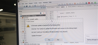

2) In image 3, it looks like IAR is asking to do a firmware upgrade of the debugger on the Launchpad. This is necessary before they can program the image onto the LaunchPad.
