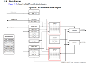

  • As the reference manual shows the FIFO size is fixed:
    (from https://www.ti.com/lit/pdf/swcu185)
  • Ter:
       Happy New Year!  Thanks for your reply.  From all the information you have provided me, I think I have stressed the UART throughput as far as I can, given the hardware platform and the transmission driver algorithm.  I wasn't so much trying to resolve an issue, but to experiment the optimal data rate with a specific application.  Thanks again for your help.
