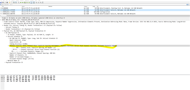

Hi Team,
I am doing an Interoperability test between CC1352P7 router node to join BR from Silicon Labs as follow https://sunmaysky.blogspot.com/2021/08/interoperability-test-between-silicon.html?m=1

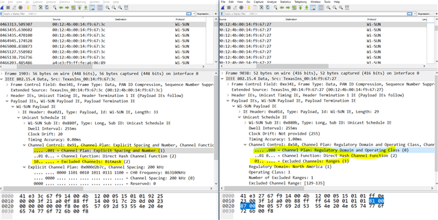

But, CC1352P7 router node is not able to join the BR. Checking from Wireshark packet capture I see that CC1352P7 sends a PAN advertising solicit (packet length 56).
Then the joining process does not go further.
Here is the attached sniffer log
GAK: e8:84:f8:64:26:01:45:96:e5:87:22:ba:fd:32:0b:49Interoperability.zip
