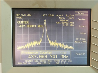

Hello! I am looking to get some help explaining some unusual behavior we have been seeing with the CC1110. We have it running in a custom PCB built on the TI 433 MHz HW example. We have been evaluating its sensitivity in the presence of a frequency offset, and we have been finding that for for negative offsets between the receiver and the transmitter (ftx<frx) the sensitivity is unchanged within the expected limit of the compensation algorithm (BWrx/2). However, for positive offsets between the receiver and the transmitter (ftx>frx) the sensitivity is significantly degraded, in an increasing manner as the offset increases. The only way we found to resolve this is to increase the preamble length to >4 bytes. However, I would expect the behavior to be symmetric - it should work for positive and negative offsets as well, right? We are using SmartRF 7 with the attached configurations to run the test. We keep the receiver frequency constant and change the transmit frequecny manually for each run, as shown in the table below. Can you offer any insights into why this may be happening?
TX Frequency (MHz) RX Frequency (MHz) RX to TX df (kHz) Outcome
437.059631 437.059631 0 Pass
437.049744 437.059631 -9.887 Pass
437.069916 437.059631 10.285 Pass
437.0448 437.059631 -14.831 Pass
437.07486 437.059631 15.229 Fail
437.039856 437.059631 -19.775 Pass
437.079803 437.059631 20.172 Fail

    Please measure the frequency offset whilst setting the Tx (437.060028 MHz) as an unmodulated carrier. Would like to determine the frequency offset in kHz so we can determine if the crystal capacitance loading is correct.
  • Sounds good - results are below, organized per board. I call the device used to transmit the test signal for measuring the sensitivity as a function of frequency offset the TX board, and the device under test which is receiving the test signal the RX board. Please ignore the power level differences shown between the two measurements - the TX board features the CC1110 only, while the RX board has an RF front end with PA in front of the CC1110 which had to be attenuated for measurement with the spectrum analyzer.
    Setting both boards to  437.060028 MHz I have observed a frequency offset of 265 Hz. We are using a 27 MHz HCMOS TCXO as a frequency reference on both boards (Fox Electronics FT5HNBPK27.0-T1) feeding the CC1110 XOSC_Q1 input via a 100R resistor to improve signal integrity.
    Looking forward to hearing your insights!

    TX board (no PA) measured frequency while setting at 437.060028 MHz is 437.059741 MHz:
    RX board (with PA) measured frequency while setting at 437.060028 MHz is 437.060006 MHz:
    Nicely tuned crystal with virtually no frequency offset, benefits with a TCXO. Always need to check this since this will affect the required Rx bandwidth.
