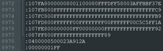

My customer is using the cc13xx-sbl tool from TI15.4 Linux Stack SDK to flash a CC2652. When they tried to flash the host_test_app.hex from <SDK>\examples\rtos\CC26x2R1_LAUNCHXL\ble5stack\hexfiles, an error occured at 71% of the programming process, with a message "Error unsupported intel hex record type 5":
Following this message, I have found that the last second line of the host_test_app.hex has a record of type 5:
Apparently cc13xx-sbl does not support record type 5 of Intel hex, my question is what does this record mean and is there a work around to make it work?

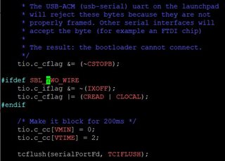

And there is another question regarding to the Linux host, on customer's board, CC2652 is connected to the host through the UART TX/RX lines directly. Does this mean they have to enable the SBL_TWO_WIRE macro instead of the default USB SBL? I have noticed there are some differences between the two modes in main.c and sblUart.c, but not quite understand the exact usage. What is the recommendation?

  • Hi Shuyang,
    Glad you found a work-around.
    Here is the explanation from the SW developer team:
    There are 3 Intel HEX formats. Intel I16HEX format support the record type from 00 to 03. The I32HEX format supports the record type from 00 to 05, but not 01.
    The record type 05 is the starting Linear address. This is the starting execution address.
    When you use the TI toolchain, the generated HEX doesn’t include the record type 05. (However, if you use the IAR ielftool to generate the HEX file, the record type 05 is included. This can help IAR debugger loading the HEX file into CPU and set the execution address by using the record type 05. )
    Below is the record 05 in hex file.
    Our SBL doesn’t support the record type 05 because we can’t tell ROM boot loader to execute from address defined in record 05.
    The fix is very simple.
    1. Using any text editor to open the hex file generated by IAR
    2. Typically, the record 05 is close to end of file.
    3. Remove the line which contains the record 05
    4. Save file.
    5. try to use cc13xx_sbl to download the saved hex file.
     Cheers,
    Marie H
