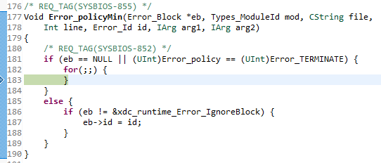

After executing the button callback (including LED toggling, radio power down and sleep), the code runs into the GPIO_enableInt function but seems to fail when disabling the HWI (on HwiP_disable()). It then runs into the infinte loop of Error_policyMin().
Below you'll find the callstack.

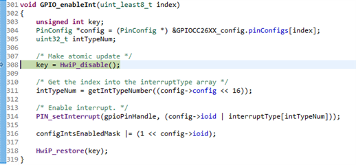

    2) I'll try to make it clearer what happens by going through step by step. The call to GPIO_enablieInt() is made by the button driver app in the file Button.c, see the code snippet below, included as an image so you can also see the line numbers for reference.

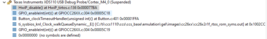

    The button driver calls my callback function in line 399, executes the code in my callback function and enters the GPIO_enableInt() function in GPIOCC26XX.c. In this function it calls the HwiP_disable function, which, I suppose, shall disable all interrupts before setting the GPIO interrupt.
    This function then calls Hwi_disable() in the source file HwiP_tirtos.c, as shown below.
    At this stage, the call stack looks like this:
    When I try to jump into the Hwi_disable function with the debugging probe, the debugger actually does not enter the function, but instead lets the code run. When I pause the debugger, I can see that it is stuck in the infinite loop of the Error_policyMin Error with the callstack I posted in my original post.
    Since this error does not occur when I comment out the RF_runCmd call in my callback function and instead toggle an LED, it works fine. So this is why this error is linked to my RF_runCmd call.
