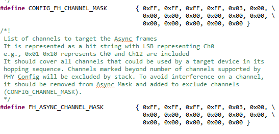

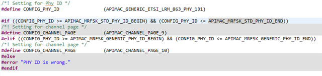

For one of our examples, we use your TI15.4 Stack. On CC1310 we run the sensor example and on CC1312 the collector example. The sensor is defined as a sleepy device and the collector is defined as non-sleepy. We are using FH mode. The question I am interested in is whether LBT is used in FH mode? I have read that CSMA is used instead and I wonder if this is the same? For a larger duty cycle, the regulation requires the use of LBT+AFA and I wonder if this is included in this case?
