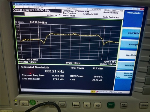

Hi Team,
My customer is using CC1312 and they can not  pass JAPAN occupied band-width test.
They try to lower TX Power but the OBW test still fail.
Please help to provide comments. Thanks.

    Please check the following:
    • What PHY is the customer using?-->2-GFSK
    • Is it a customer board or with a LaunchPad (through SmartRF Studio or something else)? -->Customer board
    • What settings are they using here?-->

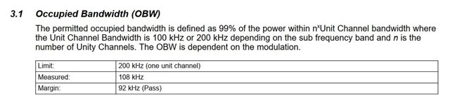

    • What is their test setup?-->
       Please see the paragraph which copy from SWRA457. In customer case , the limit will be 600Khz instead of 200Khz.
    Thanks.
  • HI,
    About "How many unit channels are they using (assuming this is T-108)", it is 3 channels, 600Khz
