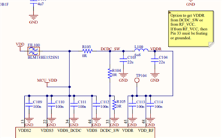

I designed a board based on CC1352R1 Dev kit. I attached the schematic. But the board doesn't transmit at all.

IoT Noise Generator_-01-A_Schematics_SMT.PDF

    Schematic:
    Not fully understanding the power options here:
    Which of the power supply options described in "11 Power Supply Configuration" in https://www.ti.com/lit/pdf/swra640 do you plan to switch between?
    For the issue you are seeing, if you are actually using a 24 MHz xtal and not 48 MHz (as CC1352R is designed for) this probably explains why you have a problem.

    In my board, resistors R103 and R105 are not placed. I was just making provision in case I needed to switch between power configuration.
    Let me investigate on the external crystal frequency.  Thanks for the hint.

  • Yes, the issue was my wrong crystal value. It's working now after I replaced a 48 MHz crystal.
