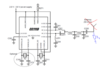

CC1110-CC1111: To what extent is the CC1110 able to drive mismatched loads without damage or reliability issues?
Part Number: CC1110-CC1111
Hello! I am interested in knowing to what extent is the CC1110 able to drive mismatched loads at 437MHz without damage or reliability issues. Let's say the antenna from the application circuit for 433 MHz is replaced by a complex load, ZL=RL+jXL. To what extent (in terms of complex reflection coefficient etc.) can this load deviate from 50 Ohms before the SoC gets damaged and/or stops being reliable?
