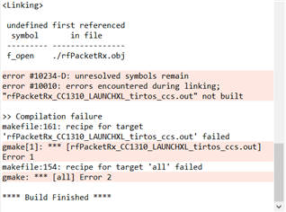

CC1310: FatFS ff.h undefined symbol f_open
Part Number: CC1310
I am trying to open a TXT file on my SD card using the FatFS libraries.
I have included all of the needed files in my code for a simple f_open operation where i create a TXT file on my SD card. However, it says it can not find f_open (see image below).
This makes no sense to me. I have included the files in my code and when i ctr+click on the #include line it opens the ff.h library perfectly fine, which is where it defines the f_open function.
I have included my code below. The lines relevant for this issue are line 30-32 and line 205.
Why am I getting this error?
Kind regards,
Mirte H

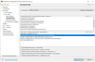

  • Hi Mirte,
    Please can you right click on the project and go to project properties.
    In the project properties window, under Build > Arm Linker, You can find the File search path.  You could add the path to the specific library you are using here.
    Sid

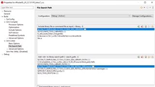

  • Hi Sid,
    Thank you for your quick response. I did try that a few times before and it didn't work so I removed all of them.
    I tried it again just now and it still doesnt work. Here is what I added:
    Kind regards,
    Mirte H
  • Hi Mirte,
    Can you try including this header file.
    #include <third_party/fatfs/ffcio.h>
    Sid
  • HI Sid,
    I added it but i still get the same error. When i change f_open to fccio_open i also get the same error but with fccio_open.

  • Hi Mirte,
    Include the path, in the "Include library file or command file as input tab"
    C:\ti\simplelink_cc13x0_sdk_4_20_01_03\source\third_party\fatfs\lib\ccs\m3\fatfs.a
    After adding this file, it seems to still expect a user defined fatfs_getFatTime() function,
    So I added a dummy implementation of this by adding the following lines of code in the application code.
    int32_t fatfs_getFatTime(void)
        return 0;
    Unless you use fatfs_getFatTime() this should be okay.
    Sid
  • Good morning Sid,
    This solved my issue! I have no more errors. I even added a few random functions (f_write, f_close) to be sure and it still works.
    It still feels weird that i have to do this much and even add a dummy to make this library usable. do you have any idea why it acts this way? (Just out of curiosity.)
    Thanks a lot! Grinning
