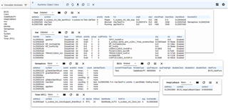

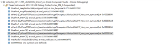

When debugging the cc1312r1 module, the program runs normally, and after about 15 minutes, the collector module does not respond to the sensor, and after pausing with the debugger, the stack is as follows:
ROV is as follows:

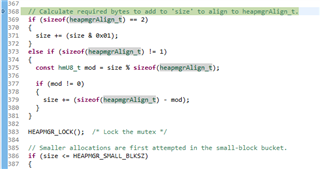

And the system does not restart (RESET_ASSERT is set) Stuck after pause in the following cycles:
(heapmgrAlign_t = 4     ;  size = 220)
Further debug found that the above issue occurs after executing the "generateTrackingRequests();" function several times after the system has started for approximately 10 minutes.
