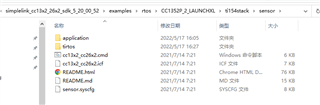

I use CC1352P, CCS v10.4, my application is based on SimpleLink SDK v5.20 as below:

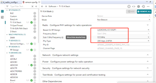

In syscfg, my radio config is as below:
After project build, CCS generate radio config code in ti_radio_config.c.

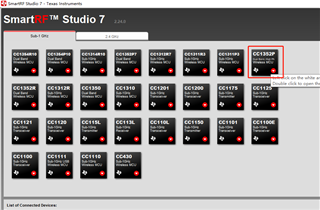

And on the other hand, I open Smart RF Studio v2.24.0, double click CC1352P as below

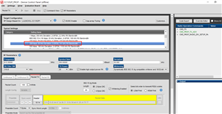

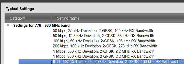

Then, I choose 915MHz, 200kbps, 310.8kHz rx bw parameter as below
I think this set of config is as same as config in CCS syscfg.

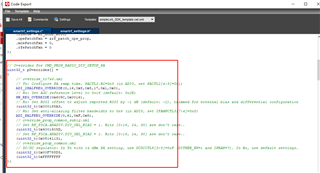

In Smart RF Studio code, pOverrides in radio setup cmd is as below:
