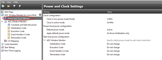

    While waiting for the next schedule the sensor controller is in Power Down mode and will be woken up in either Active or Low-power mode depending on your configuration inside the "Power and Clock settings" panel in your Sensor Controller Studio project  (see picture below).
    Switching between Active and Low-power mode can also be controlled at run-time by your application through the Dynamic Power Control API (for more information press F1 inside Sensor Controller studio -> Power management -> Dynamic power control).
    I suggest you look at the Power and clock configuration in sensor controller studio (press F1 -> Project Panel -> Power and clock settings panel) to have an idea on how to configure switching between different power-modes in your application. As well as the chapter 19.2 Power and clock management inside the TRM.
