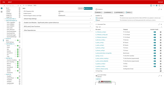

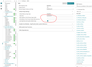

  • Can you tell me what the heapmem settings should be?
    If I enable heapmem in sysconfig and disable heap callback, then I need to either specify a heap size, or a start and end address. I'm not sure what these should be.
    I assume I need to set heapmem in the BIOS part of sysconfig?
    I am using a CC1312R launchpad and the Collector example in Ti154 stack with RTOS7
    It appears heapmem and ROV does not work with the Collector examples. I tried the gpiointerrupt which seemed ok. But following the same process, the Collector example did not work. I set the heapmem to heapStart and heapEnd from the linker script. It built okay but did not run.

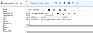

  • Hi Andrew,
    the collector example uses a different implementation of heap based on user defined callbacks (you can see the stack defined callbacks in the sysconfig module "TI RTOS->HEAPS->HeapCallback"). It can't be simply modified from syscfg, as you have verified, because the example and the stack depend on the callback functions indicated in this module.
    The ROV seems to work fine when running the collector example:
    However the heapCallback module is more limited when displaying information on the heap status. This is due to the fact that it is an application defined heap and therefore ROV does not know the internal state of it.
