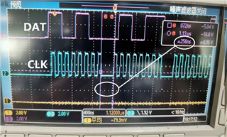

Call the SPI function library directly and modify the minDmaTransferSize to 1. If 5 bytes are written at a time, the oscilloscope shows 8*5 consecutive clock pulses with a CSN low (no interval, better SPI efficiency)
However, there is one device in the customer's actual circuit. When the device writes 5 bytes to it using SPI, it required to be separated by at least 2 every 8-tap clock before transmitting the next set of 8-tap clocks.
The customer would like to know how to increase this interval by modifying the SDK.

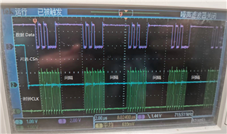

The oscilloscope waveform after implementation looks like the following picture:
Could you help check this case? Thanks.

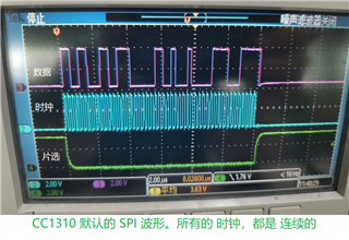

    Thanks and the customer has posted the the default SPI waveform:
    The clock signal is continuous and has no interval.

    The customer has configured SPI for DMA mode,  clock 8M and SPI_POL0_PLA0. From the oscilloscope, we can know that two 8-bit intervals is 256 ns (approximately 2 taps 8M clock). Which parameter can be modified to increase the above interval to 4-tap 8M clock?
    If DMA mode is not used, the interval is 1.38us (approximately 11px 8M clock)  and it's still large. 8-bit interval 4 shots of 8M clock is required for the customer.
    The waveform refers to the spimaster's attempt code and uses an IO to generate the CSN signal. The SPI configuration is as follows:
       spiParams.transferMode = SPI_MODE_BLOCKING; //
       spiParams.dataSize = 8; // 8-bit data size
       spiParams.mode = SPI_MASTER; //SPI MASTER
       spiParams.frameFormat = SPI_POL0_PHA0;
       spiParams.bitRate = 8000000;
    Thanks and regards,
    Cherry

  • Hi Cherry,
    When setting up the transfer in DMA mode the driver will not interfere with the SPI module once the transaction is started. the DMA HW module will automatically load bytes in the SPI TX FIFO and the SPI IP will transfer data as fast as it is allowed to run. Unfortunately there is no parameter or HW configuration of the SPI module allowing you to select the time interval between consecutive bytes (I couldn't find any setting in the TRM for the SSI module regarding this). The recorded time interval from your last post derive from the execution time of the code between one byte and the next. Therefore I don't think this use case is supported by our device. The customer will have to use either ~2 clock cycles (DMA transaction), ~11 clock cycles (non-DMA transaction) or implement a scaled down version of the SPI driver where they can have more accurate timing control.
    Fausto
