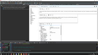

 I got some errors from the ROV. I don't know how to fix it.
Error: java.lang.Exception: Target memory read failed at address: 0x2000771c, length: 12 This read is at an INVALID address according to the application's section map. The application is likely either uninitialized or corrupt.
Error: java.lang.Exception: Target memory read failed at address: 0x2000673c, length: 20 This read is at an INVALID address according to the application's section map. The application is likely either uninitialized or corrupt.

  • Hi Nikolaj,
    I got that Semaphore error in ROV after calling GPIO_init()
    I got that Event error in ROV after calling Event_create()

  • Hi Andrés,
    Thanks for your linker file. I believe this is an issue related to auto-sized heap.
    Please refer to the "Warning" box in the "ROV in IAR" here: https://dev.ti.com/tirex/content/simplelink_cc13xx_cc26xx_sdk_6_10_00_29/docs/ble5stack/ble_user_guide/html/ble-stack-5.x-guide/debugging-index.html#rov-in-iar
    It is suggested to add some lines to the \kernel\tirtos\packages\ti\sysbios\heaps\package.xs file in the SDK.
    Even though this is mentioned for IAR, I am able to reproduce your issue in CCS using osal heap manager, and the workaround mentioned in above guide fixed my issue.
    If I use the HeapMem instead of the legacy osal heap manager, then I am also not seeing the issue (without the workaround).
    So I would suggest to either use the HeapMem (or HeapTrack) heap manager instead of the osal heap manager or apply the workaround to  \kernel\tirtos\packages\ti\sysbios\heaps\package.xs as mentioned in above guide.
