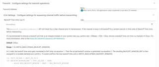

…. So using the stock dmm for Sub1GHz + BLE project; I see it calling EasyLink_transmit and EasyLink_asyncReceive for the Sub 1GHz stuff.  All good, but when I look in the .syscfg there’s this section in Easylink with the CCA parameters; that is, the Listen-Before-Talk parameters of the Sub 1GHz piece.  I am unclear if the CCA parameters are actually used or not; it USED to be that you had to call EasyLink_transmitCcaAsync(); but the fact that those parameters are included coupled with what I think I see happening makes me think they are actually being observed.
So to the real question(s)-
  1. Are they in fact being used (if I am only calling EasyLink_transmit, not the EasyLink_transmitCcaAsync, and if so,
  2. Is there a way to turn them off (eg if I put 0’s in some/more of the backoffs or something in the .syscfg would it stop listening?
I am thinking I may need to get to a ‘shout’ mode; eg if I get back’d off too many times in a row then I decide to just talk regardless.  Like anything RF, it’s a little hard to say I know exactly what’s happening; but I think I am seeing a case wherein my sensors aren’t talking like they should be in the presence of a ‘loud personality’ (that is, a really noisy environment)

    When looking through the code, it seems like CCA is only used for EasyLink_transmitCcaAsync(). This is also mentioned in the description of the CCA fields in sysconfig. See below:
    So CCA will not be used, unless you are using EasyLink_transmitCcaAsync. To help with debugging your issue you can debug the application and check the status returned by EasyLink_transmit and EasyLink_transmitAsync, and also the status parameter in the callback for EasyLink_transmitAsync.
