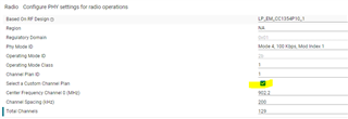

in the example provided in the Resource explorer about the Wisun Border Router and Coap Node,
Only 4 Region(in the  .syscfg file) can be Selected,
Its sad that the 4 dont have the one i needed,
is that or a timetable that TI team will release other profile for different region?
Or is that a way(Or any documentation) i can follow to adjust the parameter in .syscfg file
like
Channel Plan ID
UniCast Channel Mask
that i can adjust and know how is that related to the PHY specification?
THanks
Jeff

  • Hi Jeff,
    I'm very sorry for the delayed response.
    Unfortunately the region profiles you requested are not yet available. However, you can always manually specify the values for your region profile inside the sysconfig interface as below:
    Regarding the PHY specification you should use, The PHY ID corresponds to the PHY descriptor to be used based on the region of operation. It is automatically configured based on the selections made for frequency band, modulation, and data rate.
    When creating a custom region profile you can refer to the Data-Rate and PHY section of the TI15.4-Stack User's Guide to select the optimal configuration.
    Fausto
