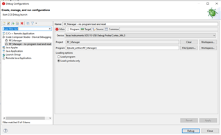

I have done all the recomendation from connect-the-debugger-to-a-running-target in order to do it.
The target is not reset but it is still on halt after debuger connection.
The question is what more have to be done in order target to not be halted?
Used CCS version: 11.1.0.00011.
Gel reset in gel file is commented.
Debug settings:
    We are able to reproduce this issue. This seems to be an issue that has been introduced in a recent version of CCS (CCS 11.0 and newer), we are looking into the issue.
    At the moment, I am not aware of any workaround except using an older version of CCS (but that could potentially cause other issues, if some products, for example the SDK, requires a newer version of CCS)
