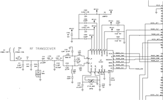

CC1101: concerns about the 25K bandwidth and stability
Part Number: CC1101
we are facing a narrow bandwidth issue, please have a look on schematic (attached below) and please let me know if we do anything temperature compensation and how we can maintain the stability at such narrow bandwidth
TAS-3225j Crystal Oscillator is being used which has the frequency tolerance of 5PPM
