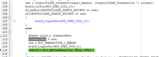

  • Hi Sid,
    The value of transactRes is 1
    I was confused with the lower enum, now I see CRYPTOCC26XX_OP_AES_CCM_ENCRYPT_AAD_ONLY is not refer to the upper enum CRYPTOCC26XX_STATUS_
    I didn't protect the following functions by a semaphore. which functions must be protected?

  • Hi Sid,
    This is my function:
    There is no call in my project to any of the functions you mentioned in your reply.
    I don't use cryptoTransactionExecute function.
    void AES_CBC_encrypt( CryptoCC26XX_Handle crypto_Handle,
    CryptoCC26XX_Params cryptoParam,
    const AESCBCinfo_t *sAESCBCinfo,
    uint8_t conversiontMode )
    int keyIndex;
    CryptoCC26XX_AESCBC_Transaction trans;
    // Initialize transaction
    CryptoCC26XX_Transac_init((CryptoCC26XX_Transaction *) &trans, conversiontMode);
    // Attempt to open CryptoCC26XX.
    bool exclusiveAccess = false;
    crypto_Handle = CryptoCC26XX_open(Board_CRYPTO, exclusiveAccess, &cryptoParam);
    PG_Assert(crypto_Handle);
    keyIndex = CryptoCC26XX_allocateKey(crypto_Handle, sAESCBCinfo -> ui8AESKeyLocation,
    (const uint32_t *) sAESCBCinfo -> ui8AESKey);
    if (keyIndex != CRYPTOCC26XX_STATUS_ERROR)
    // Setup transaction
    trans.keyIndex = keyIndex;
    trans.nonce = (uint32_t *) sAESCBCinfo -> ui8AESInitVector;
    trans.msgIn = (uint32_t *) sAESCBCinfo -> ui8AESClearText;
    trans.msgOut = (uint32_t *) sAESCBCinfo -> ui8AESMsgOut;
    trans.msgInLength = sAESCBCinfo -> msgInLength;
    // Do AES-CBC operation
    int res = CryptoCC26XX_transact(crypto_Handle, (CryptoCC26XX_Transaction *) &trans);
    PG_Assert(CRYPTOCC26XX_STATUS_SUCCESS == res);
    if(CRYPTOCC26XX_STATUS_SUCCESS == res)
    board_togglePin(NOT_USED_IOID_10);
    else
    nop();
    CryptoCC26XX_releaseKey(crypto_Handle, &keyIndex);
    int crptoClose = CryptoCC26XX_close(crypto_Handle);
    PG_Assert(CRYPTOCC26XX_STATUS_SUCCESS ==crptoClose);
    else
    nop();
    PG_Assert(CRYPTOCC26XX_STATUS_SUCCESS ==keyIndex);
    This is the reason I get the error.
