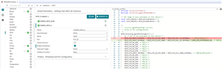

    You can check what SySconfig generates for the required settings of the GPIO.
    I see that for setting up the pin as input mode, with a pull up and hysterisis enabled, the ti_drivers_config.c has:
    GPIO_CFG_INPUT_INTERNAL | GPIO_CFG_IN_INT_NONE | GPIO_CFG_PULL_UP_INTERNAL | GPIO_CFG_HYSTERESIS_ON
