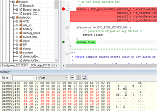

I upgrade my system to TIRTOS7.

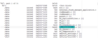

When I call to ECC_generateKey() i see overwriting memory on ram memory :
Addresses  0x2000014B- 0x200001b0
In map file you can see that this memory allocated to other parameters :
This problem not happened when I used with TIRTOS old version
Ho I can fixe it ?
Thank
Yaki

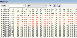

  • Hi SId ,
    We are in holiday season in Israel so my answer is delayed , Sorry .
    Answer 1 : In TIRTOS and TIRTOS7 I see that the same memory is change .
    Ti RTTOS :
    Answer 2 : It look like in TIRTOS the memory not used by other parameters
    Yaki
  • Hi Yaki,
    No problem, I think the behavior of the API ECC_generateKeys cannot be changed. But what we can do is try to protect the memory area by keeping a variable there with a big enough size in that location, so that the TIRTOS7 constructs are not placed in that memory location. This location will be written by the ECC_GenerateKey function, but this should not be a problem since this is a dummy variable that should not be used in the code.
    This is compiler dependent.  Which compiler are you using?
    Sid
    We are using IAR compiler .

  • Hi Sid ,
    I succeeded to work with ECC_generateKeys by protect the memory .
    And now I try to move to new driver and work with ECDH_generatePublicKey .

  • Hi Fausto ,
    We agree that if I used with the same  myPrivateKeyingMaterial as based key we need to get the same result from both API's ?
    Below I show the process that I implement one is based on "ECC_generateKeys" (Old implementation ) and second based on "ECDH_generatePublicKey"
    In both  process I used with the same myPrivateKeyingMaterial as based key.
    Please see the code below :
    Common key definition
    uint8_t myPrivateKeyingMaterial[CURVE_LENGTH] = {0x00, 0xCC, 0x00, 0xDD, 0x00, 0x00, 0x00, 0xEE,
    0x00, 0xBB, 0x00, 0xEE, 0x00, 0x00, 0x00, 0xEE,
    0x00, 0x00, 0x00, 0x00, 0x00, 0x00, 0x00, 0xEE,
    0x00, 0xDD, 0x00, 0xDD, 0x00, 0x00, 0x00, 0x01};

    Process based on "ECC_generateKeys "
    uint8_t ecc_genKeys(eccData_t* p_eccData)
                 uint8_t status = true;
                 /* Allocate workzone memory for ecc, recommended workzone size is 275 bytes */
                 uint8_t workzone[275*ECC_WINDOW_SIZE];
                memset(workzone, 0, 275*ECC_WINDOW_SIZE);
                /* Initialize ECC with a pointer to the allocated workzone */
               ECC_initialize((uint32_t *)workzone);
               /* Buffer for the private key generated */
               uint8_t eccPrivateKey[ROM_MODULE_KEY_LENGTH] = {8};
               memcpy(eccPrivateKey + ECC_KEY_LENGTH_OFFSET,myPrivateKeyingMaterial,ECC_KEY_LENGTH);
                /* Generate public key pair for this unit by using elliptic curve cryptography
                 * The local private key is used as the random input, generating the same private key
                 * as the local private key
                status = ECC_generateKey((uint32_t *)eccPrivateKey,
               (uint32_t *)p_eccData->privateKey,
               (uint32_t *)p_eccData->publicKeyX,
               (uint32_t *)p_eccData->publicKeyY);
               //All Keys stored in p_eccData parameter
               if(status != ECC_ECDH_KEYGEN_OK) {
                  /* generation of public key failed */
                 return false;
              return true;
