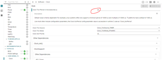

I am using the sub 1 GHz RF on the CC1352R1 to accomplish time synchronization between two CC1352R1 eval boards and to send timing signals. I am using TI-RTOS & SDK version 6.20.00.29. Once the clocks are synchronized, I calculate the next time a timing signal needs to be sent. I then use a clock object from the TI-RTOS clock module (explained here: TI-RTOS Kernel (SYS/BIOS) User's Guide, section 5.2), input the calculated time until the next time a signal needs to be sent as a timeout to the clock object. Then I use a period on the clock object to fire a callback function which outputs signals on an IO pin for the rest of the timing signals.
I take care of any latency delays due to the RF communication and processing overhead but I am seeing a jitter from the output of the clock module and GPIO pin of 5 - 10 microseconds.
Is there any way to get this jitter below a microsecond? Are there any changes or performance improvements I can make in the code or in TI-RTOS to reduce this jitter of the clock module and GPIO module? The signal I am comparing my output to is a hardwired signal that has a jitter of less than 25 nanoseconds, so any jitter on the order of microseconds is not due to the source signal.

  • So far I am planning to resync the clocks every 1 second (haven't actually implemented it yet) as the drift on the clock module quickly makes the timing incorrect after about 1 second. The original jitter numbers were measured from an oscilloscope capturing 8 pulses from the clock module.
    Thanks for finding that other thread, I will need to find the code I wrote for that to see what overrides I used.
    To sync the clocks, I capture a timestamp in an interrupt on the transmitting side, add 100 ms, then use an absolute trigger to send at the correct time. On the receive side, append an RX timestamp, receive timestamp packet at correct time, I started with a fixed delay for the time from TX to RX high sync signal as (Preamble bit + syncword bits) * microseconds/symbol rate -> convert to RAT ticks. After some testing I decreased this delay by 382 microseconds, which allowed me to get my start time to within a couple of microseconds consistently. I then use the clock module with a period of 100 ms to output the rest of the pulses from there but am running into issues with jitter & drift as mentioned above.

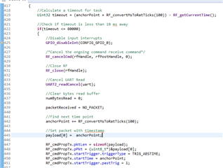

  • Arthur,
    I apologize for the late reply. I have not tried the radio timer yet because it is more convenient to utilize the periodic function of the clock module. Is there a way to set an absolute time trigger for the sub 1 GHz RF TX and also utilize the RF TX drivers to transfer data until that time?
    Right now, I am using the default example for a abs trigger which shuts down the radio until a couple of ms before the trigger time where the radio then wakes up. This is the code I am using currently:
    This sets the next timestamp to trigger at based on a pre-calculated time (earlier in the code), loads the payload (with timestamp) and runs the RF command where it will enter an idle state waiting for the trigger time. What I want to do is keep this functionality but still be able to send data across the RF until the trigger time. Then send a packet at the correct trigger time. Is this possible without having to reconfigure the radio everytime? Up to this point, I have assumed it is not because when I am sending regular data through the RF, I am utilizing a trig now trigger type for the RF TX rather than abs trig.

  • Arthur, I can't really schedule TX commands because I am using the board to relay information through the RF and therefore, do not know when data will come in over UART. The idea is when data comes in over UART -> immediately send to other board via the RF. When something is received via RF, then send through the UART driver immediately. However, in between this messaging, I need to send a timestamp periodically through the RF. Accuracy is important so I was utilizing the absolute time trigger of the TX function. I am calculating a timeout until I need to send the next periodic timestamp. About 20 ms prior to when the timestamp is supposed to be sent, I cancel the ongoing UART & RF read, close the RF driver, reconfigure the TX RF function to be absolute time trigger, reopen the connection to the RF driver, set the frequency, and run the TX command to send the timestamp at the TRIG ABS time. However, this does not work, I get a random error every time I debug the code, something along the lines of:
    This doesn't give much information so it is pretty impossible to debug. Do you know of anyway to fix or debug this? Here is the code where it happens (that I described the function of above):
    The error described above happens when the RF TX command is run with RF_runCmd

  • Arthur,
    Yes I used the RF UART bridge as a base to send data. I am using the absolute trigger to send time stamps, I am running into issue when closing the RF connection & changing parameters and then reopening the RF driver. Either I will get a random error (break at address 0xXXXXXXX as above) [EDIT: This is not really an error technically,  but it doesn't help with debugging because the processor is executing some assembly or other type of code that CCS can't display so I can't see or understand how it is getting stuck there] or the RF will not send at the trigger time (it just simply does not send anything). I am attempting to accomplish this using TI RTOS utilizing two tasks and clock objects. However, I have reconfigured the timing part to utilize a 32 bit timer which is simpler and seems to have better performance (less jitter & drift) than the clock objects. Right now I am attempting to move all the code to No RTOS using states similar to the way the RFSynchronizedPacket examples work.
    The reason I need to reconfigure the RF is I need to resync the clocks once every second or so because the internal oscillator on the receiving TI board has a significant amount of drift that changes the timing signal by multiple microseconds. So I reconfigure the RF driver to do an absolute time trigger based on a new anchor point received from the reference device. Once sent, the receiving board recalculates the time delay between the two clocks and uses that to calculate the next timestamp. Obviously, having a tuned external oscillator would make this less of an issue but the eval board I am using doesn't have that option.

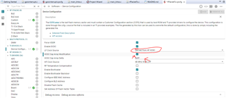

  • Tyler,
    Through your explanation, I realized something.
    Could you try disabling automatic RFcore power up calculation by setting to, let's say, 2500 (default value in RF core driver)?
    https://dev.ti.com/tirex/explore/content/simplelink_cc13xx_cc26xx_sdk_6_30_00_84/docs/rflib/html/struct_r_f___params.html#a58dc682aa09acabe6411ea186dd3aebf
    Given you turn the RFCore on and off repeatdly, that could help with the jitter you are observing.
    Let me know the results,
    Arthur
  • Arthur,
    I setup that parameter as such:
    Is this correct and what you had in mind? If so, I will test it today.
    Also any help on why the RF driver errors out or does not work when closing the radio connection, reconfiguring to do an absolute trigger, and then reopening the connection and running a TX command?
  • Hi Tyler,
    This is what I had in mind indeed.
    About the error, I am not sure I have ever seen that, but do you happen to modify RF_cmdPropTx in the two different threads you talked about?
    Arthur

  • Hi Tyler,
    We already do use the external crystal, when the chip is in active mode.As of your suggestion, I am not certain this will have an effect.
    We have two new options for you to test. We know for a fact that clock drift happens when the device wakes up from standby. We also know that TI-RTOS uses the LF clock for its Clock Module. Thus:
    _ Could you derive the LF Clock from the HF XOSC? This will have the side effect of disabling standby mode on your device.
    _ If there is a visible drift between your two devices, you could try tuning the internal crystal capacitor array yourself so that they match better.
    In both cases, refer to the picture:
    Arthur

  • Moreover, I noticed this in Sysconfig:
    Could you try lowering that value?
    Arthur

  • Hi Tyler,
    Did you observe anything more? I am especially interested in knowing whether the CAP_ARRAY_DELTA modification made any difference.
    Arthur
