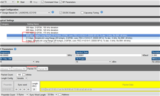

Here's the request from the customer:
Customer needs to modify different modes according to different airspeeds, as shown in the figure below, for example, the legacy long range mode used by 625bps, when he switches to 5kbps, he wants to use the simplilink long range.
According to the file comparison of the smartrf_settings.c files generated by each airspeed, he had modified the different parameters, but found that the communication still could not be communicated after the modification.
He needed to know the parameters in the generated smartrf_settings.c before which step of the main function called, and how to modify and switch parameters. The figure below is a screenshot of some of the modified parameters, as well as the modified statement before RF initialization.
What's more, using the search function, customer can't see where the parameters of smartrf_setting.c are assigned.
Could you help check this case? Thanks.
Nick
  • I am not sure I understand the figures you are showing or what the actual problem is.
    If the customer wants to use both the legacy lrm (625 bps) and the SimpleLink lrm (5 kbps) he needs to include all the settings/overrides/patches for both mode in his smartrf_settings files:

    To change between the PHYs, you can simply open the RF driver with one PHY, do whatever you want, close the driver, and then open it up again with the other PHY.
    The code export in Smartrf Studio will only give you one PHY at the time, so you first have to export one PHY, rename it, then export the other one, and paste the settings into the first file (or you can have two different SmartRF_settings files in your code, with different names for the different PHYs.
