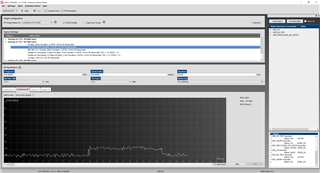

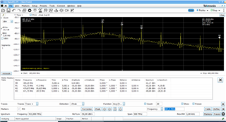

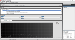

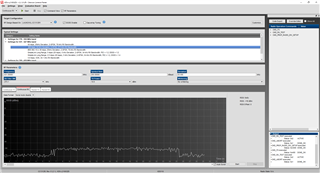

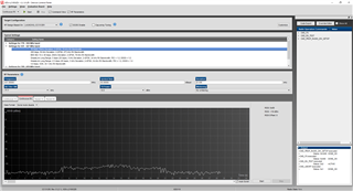

we have a problem with our CC1312R custom board.
We are able to replicate this behaviour on LaunchXL-CC1312R1.
The noise floor (RSSI) increases up to 25-30 dB (SmartRF Studio cont. RX), independent from data rate.
good setting: 78kHz rx bandwidth
bad setting: 273kHz bandwidth
Conducted (50Ohm terminated) is no problem - same noise floor, but with external 433MHz antenna we have the problem.
There is no external disturbance in environment, we measured also in a shielding box.
Changing the crystal to TCXO on LaunchXL-CC1312R1 brings no improvement. Harmonics of crystal couples to pcb.
Thanks in advance.
measurements LaunchXL-CC1312R1:
image 1: passage from no antenna to antenna with  78kHz rx bw
image 2: passage from antenna to no antenna with  273kHz rx bw
image 3: spectrum crystal
image 4: spectrum TCXO
passage from no antenna to antenna passage with antenna to no antenna dpectrum crystal spectrum TCXO
