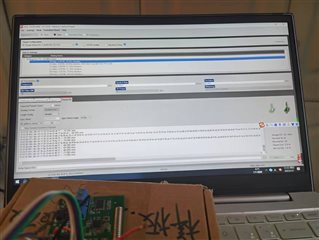

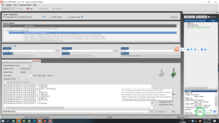

  • Hi Diego,
    After customer referring to the Migrating from CC1101 section in CC13x0 documentation (software-dl.ti.com/.../cc1101-migration.html) , he connected the CC430F5137 and CC1310 with two computers and found that the CC1310 receiver had a CRC error when the distance between the two is greater than 9 meters, but the signal RSSI strength is still good.
    Smart Studio 7 screenshot below:
    The waveforms can be aligned at the center frequency points that has previously captured with the spectrometer.
    Nick
  • - Please post screenshots and not a photo of the screen for better readability
    - Check the frequency offset between the TX and RX devices.  Please post the result of "The waveforms can be aligned at the center frequency points that has previously captured with the spectrometer.". Note that a RBW of 1 kHz or less should be used.
    - Do you have a lot of noise on the frequency you are trying to use?
