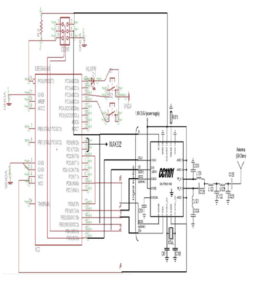

i am using CC1101 as transciever.
output power level is very low though it is transmitting data. i checked it on hyperterminal.
So Receiver is not receiving any data.
 can anyone pls tell me the reason for it???
  • i also forgot to mention that circuit is drawing very less current.

  • i am attaching the circuit diagram.
    Also can u tell me  are  there any settings that needs to be done if i am using a new ic of cc1101(first time)???
    i am able to transmit data from controller to cc1101 but not getting any  RF output from it.
    Also if i give a 433Mhz signal from outside from rf signal generator, there is no output on SO line which goes to MISO further,
    Plz help me out.
    is the ic not working or are there any settings that  i am not aware of while using cc1101 for the first time??
  • There are really only two reasons for the CC1101 to be pulling low current.  1) the ground pad under the chip is not properly connected, or 2) the chip has not received the appropriate commands to place it into either receive or transmit.
    Many people are caught off guard by the ground connection under the part and this can be especially difficult to manage for prototype builds where assembly is done on a lab bench rather than with a reflow oven as on a manufacturing line.  Not that it is impossible to solder on a lab bench, just that it can be difficult and if not practiced, may take several attempts to get it right.
    The second issue is generally for people who are working with these radios for the first time.  You can use the SmartRF Studio software (http://focus.ti.com/docs/toolsw/folders/print/smartrftm-studio.html) to help you create the appropriate register settings for the part to work in your application.  Note that the part does not power up ready to transmit or receive, you must initialize it with the proper set of commands to make this happen not only the first time you power it on but every time you power it on.

  • hello sir
    it started working yesterday and was properly receiving data packets till last night.
    the die pad was not grounded as you said.
    it drew current and buzzer sounded every time it received a data packets as per my code.
    but it stopped working today morning :-(
    now on receiving a data packet it sounds a buzzer just once and current drops to zero.
    it sounds buzzer everytime we reset the ckt and then it doesnt.
  • It is possible your circuit originally was marginally working due to some debris or extra solder flux providing a workable ground connection.  Perhaps moving the board or doing some other rework has dislodged whatever debris was letting it work and now you need to reflow the part.
    Beyond this suggestion, I really cannot provide you much.  Intermittent systems, especially if there are no code changes between working and not working, are always frustrating to debug.  Persistence and creativity are about the only tools you have.
    Good luck,
    Jim Noxon

                UCSRB = (1<<RXEN)|(1<<TXEN);		// Enable receiver and transmitter
                UCSRC = (1<<URSEL)|(1<<USBS)|(3<<UCSZ0);// Set frame format: 8data, 2stop bit
            void USART_Transmit( char data )
                while ( !( UCSRA & (1<<UDRE)) )		// Wait for empty transmit buffer
                UDR = data;				// Put data into buffer, sends the data
            void Check_If_Done(char *str)
                while(*str)
                    USART_Transmit(*str++);
            void SPI_MasterInit(void)			//Initialize Atmega8 as master
                DDRB = (1<<DDB5)|(1<<DDB3)|(1<<DDB2);	// Set MOSI,SCK and SS\ output, all others input
                SPCR = (1<<SPE)|(1<<MSTR)|(1<<SPR0);	// Enable SPI, Master, set clock rate fck/16
            void SPI_MasterTransmit(char cData)		//Transmit data on the SPI interface
                SPDR = cData;				// Start transmission
                while(!(SPSR & (1<<SPIF)))		// Wait for transmission complete
    		void TransmitUDPacket(char *str)
        char sync[] = "SYNC TX";
        char pkt[] = "PACKET TX";
        //CSn(0);
      //  while(bit_is_set(PINB,4)){}
         SPI_MasterTransmit(0x36);     //idle mode
    	 SPI_MasterTransmit(0x3A);     //rx flush
    	  _delay_ms(50);
    	 SPI_MasterTransmit(0x33);	   // scal strobe
        SPI_MasterTransmit(0x35);
        SPI_MasterTransmit(0x7F);        //write TXFIFO
        while(*str)
            SPI_MasterTransmit(*str++);
    		SPI_MasterTransmit(0x3B);
       /* while(bit_is_clear(PINB,0))
        //PORTC=0x01; //set PC0 high
        //delay_ms(100);
        Check_If_Done(sync);            //print SYNC TX when sync transmission gets completed
        while(bit_is_set(PINB,0))
        //PORTC=0x00;
        Check_If_Done(pkt);            //print PACKET TX when packet transmission gets completed
        //CSn(1);
            void SPI_MasterReceive(void)
                char RegValue, i;
                char ReceivedValue[11];
    			unsigned char c;
    			float RSSI_dec;
    			float RSSI_dBm;
    			char trans[3];
    			trans[0]= 'h';
    			trans[1]= 'i';
    			trans[2]= '\0';
                char on[]="ON";
                char off[]="OFF";
                SPI_MasterTransmit(0x3D);
                RegValue = SPDR;
                USART_Transmit(RegValue);
                for(i=0; i<11; i++)
                    ReceivedValue[i] = SPDR;
                if((ReceivedValue[0]=='a') & (ReceivedValue[1]=='b') & (ReceivedValue[2]=='c') & (ReceivedValue[3]=='d') & (ReceivedValue[4]=='e') & (ReceivedValue[5]=='f') & (ReceivedValue[6]=='g') & (ReceivedValue[7]=='h'))
                    if((ReceivedValue[8]=='y'))
                       PORTC|=((1<<PC0)|(1<<PC1)|(1<<PC2));
    				   Check_If_Done(ReceivedValue);
                            _delay_ms(250);
    					TransmitUDPacket(trans);
    					Check_If_Done(trans);
                        PORTC&=~(1<<PC0);
    				/*c=ReceivedValue[9];
    				RSSI_dec=(float)c;
    				if(RSSI_dec>= 128)
    				RSSI_dBm =((RSSI_dec - 256)/2 - 74);
    				else
    				RSSI_dBm =((RSSI_dec)/2 - 74);
    				 if(RSSI_dBm<(-107))
    				PORTC|=(1<<PC0);
    				 _delay_ms(1000);
                    PORTC&=~(1<<PC0);
    			/*	if (RSSI_dec<190)
    				PORTC|=(1<<PC0);
    				 _delay_ms(1000);
                    PORTC&=~(1<<PC0);
                    /*else if((ReceivedValue[8]=='n'))
                        PORTC&=~((1<<PC1)|(1<<PC2));
                        PORTC|=(1<<PC0);
                            _delay_ms(1000);
                        PORTC&=~(1<<PC0);
                        Check_If_Done(off);*/
            void CSn(int i)					//Toggle CSn
                if(i==1)
                PORTB|=0x04;
                else
                PORTB&=0xFB;
            void Write_RegConfig(char addr,char value)	//send register value of a particular register
                SPI_MasterTransmit(addr);
                SPI_MasterTransmit(value);
            void Full_RegConfig(void)			//for full register configuration using BURST access
                CSn(0);
                SPI_MasterTransmit(0x3E);		//address for patable access
                SPI_MasterTransmit(0xC0);		//patable for PA power control settings
                SPI_MasterTransmit(0x40);		//burst transfer 1st address
                SPI_MasterTransmit(0x29);		//data written at register 0x00
                SPI_MasterTransmit(0x2E);		//data written at register 0x01
                SPI_MasterTransmit(0x06);		//data written at register 0x02
                SPI_MasterTransmit(0x47);		//data written at register 0x03
                SPI_MasterTransmit(0xD3);		//data written at register 0x04
                SPI_MasterTransmit(0x91);		//data written at register 0x05
                SPI_MasterTransmit(0x3D);		//data written at register 0x06
                SPI_MasterTransmit(0x04);		//data written at register 0x07 EARLIER 04
                SPI_MasterTransmit(0x01);		//data written at register 0x08 EARLIER 05
                SPI_MasterTransmit(0x00);		//data written at register 0x09
                SPI_MasterTransmit(0x00);		//data written at register 0x0A
                SPI_MasterTransmit(0x06);		//data written at register 0x0B
                SPI_MasterTransmit(0x00);		//data written at register 0x0C
                SPI_MasterTransmit(0x10);		//data written at register 0x0D
                SPI_MasterTransmit(0x09);		//data written at register 0x0E EARLIER A7 866
                SPI_MasterTransmit(0x7B);		//data written at register 0x0F EARLIER 62 866
                SPI_MasterTransmit(0xF5);		//data written at register 0x10	CA
                SPI_MasterTransmit(0x75);		//data written at register 0x11	EARLIER 83 866
                SPI_MasterTransmit(0x03);		//data written at register 0x12	13
                SPI_MasterTransmit(0x22);		//data written at register 0x13
                SPI_MasterTransmit(0xE5);		//data written at register 0x14	EARLIER F8 866
                SPI_MasterTransmit(0x14);		//data written at register 0x15 EARLIER 15 866
                SPI_MasterTransmit(0x07);		//data written at register 0x16
                SPI_MasterTransmit(0x30);		//data written at register 0x17
                SPI_MasterTransmit(0x18);		//data written at register 0x18
                SPI_MasterTransmit(0x16);		//data written at register 0x19
                SPI_MasterTransmit(0x6C);		//data written at register 0x1A
                SPI_MasterTransmit(0x03);		//data written at register 0x1B
                SPI_MasterTransmit(0x40);		//data written at register 0x1C
                SPI_MasterTransmit(0x91);		//data written at register 0x1D
                SPI_MasterTransmit(0x87);		//data written at register 0x1E
                SPI_MasterTransmit(0x6B);		//data written at register 0x1F
                SPI_MasterTransmit(0xF8);		//data written at register 0x20
                SPI_MasterTransmit(0x56);		//data written at register 0x21
                SPI_MasterTransmit(0x10);		//data written at register 0x22
                SPI_MasterTransmit(0xE9);		//data written at register 0x23
                SPI_MasterTransmit(0x2A);		//data written at register 0x24
                SPI_MasterTransmit(0x00);		//data written at register 0x25
                SPI_MasterTransmit(0x1F);		//data written at register 0x26
                SPI_MasterTransmit(0x41);		//data written at register 0x27
                SPI_MasterTransmit(0x00);		//data written at register 0x28
                SPI_MasterTransmit(0x59);		//data written at register 0x29
                SPI_MasterTransmit(0x7F);		//data written at register 0x2A
                SPI_MasterTransmit(0x3F);		//data written at register 0x2B
                SPI_MasterTransmit(0x81);		//data written at register 0x2C
                SPI_MasterTransmit(0x35);		//data written at register 0x2D
                SPI_MasterTransmit(0x09);		//data written at register 0x2E
                CSn(1);
            void SimpleReceive(void)
    			//char RSSI_value;
                while(1)
                CSn(0);
                //while(bit_is_set(PINB,4)){}
    			 _delay_ms(100);
                SPI_MasterTransmit(0x34);		//SRX STROBE
                while(bit_is_clear(PINB,0)){}
                while(bit_is_set(PINB,0)){}
                Check_If_Done(pkt);
                SPI_MasterTransmit(0xFF);		//BURST READ RXFIFO
                SPI_MasterReceive();
    			//SPI_MasterTransmit(0xF4);
    			//RSSI_value=SPDR;
    			//USART_Transmit(RSSI_value);
                CSn(1);
            int main()
                char done[] = "Done";
                char start[] = "Start";
                DDRC =(1<<DDC2)|(1<<DDC1)|(1<<DDC0);	// 0 for Buzzer, 1 for LED, 2 for Relay
                PORTC =(1<<PC2)|(0<<PC1)|(0<<PC0);
                SPI_MasterInit();
                USART_Init();
                Check_If_Done(start);
                Full_RegConfig();			//CC1101 configured
                Check_If_Done(done);
                SimpleReceive();
                return 0;
    ccurs.
    i am attaching the receiver code.please go through it. earlier i gave u the transmitter code.
  • Hello Sir,
    I am facing a peculiar problem.
    CC1101 is transmitting well but not able to receive the data packet.
    The codes are well tested.Can it be a hardware problem???
  • Sure, it can be hardware.  I recently debugged an issue where the 56k bias resistor was replaced with a 56 ohm resistor.  This caused an asymmetric response between transmit and receive, the distance in receive was about 2 orders of magnitude shorter than in transmit.  That's not to say this is your problem but just to show there can be real hardware issues that cause asymmetric operation of the RF path.
    Usually when people have these types of problems it generally is a configuration issue.  When you say the code is well tested, how do you know that.  Does it run on one of the EM boards properly but not on yours?
    I'll need a bit more information to be able to help you much.
    Jim Noxon
  • Yes sir it did run on the similar boards...but now when i have the new pcb with me..it's not receiving but it is doing the transmitting part....
    That it is transmitting, grounding of the die pad won't be a problem i guess...
    What could be the problem then???
  • There's really no way for me to tell exactly.  My suggestion is to make sure all the components (bias resistor, bypass capacitors, etc.) match what the reference designs use.  Also make sure the RF path is using good quality components to minimize tolerance issues.  Finally, does your layout conform to one of the reference designs especially with respect to the bypass capacitors and power line traces.  The last item can have a significant effect on generation of asymmetric operation as different power pins are more closely associated with RX and TX blocks within the parts.
    Jim Noxon
