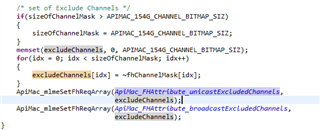

During testing, I found out that if we reduce the number of channels actually used, as defined in CONFIG_FH_CHANNEL_MASK, something like the following:
#define CONFIG_FH_CHANNEL_MASK        { 0x55,0x55,0x55,0x55,0x55,0x55, \
                                        0x55,0x00,0x00,0x00,0x00 }
The amount of time a sensor node needs to join network will be significantly reduced, roughly proportional to the number of channels actually used. Also in theory if we use different channels for different networks, even those networks co-exist in close vicinity. they won't interfere with each other. We can also avoid interference from other systems.
So my question is: how do we dynamically set different channels for different networks? Should we include all channels in FH_ASYNC_CHANNEL_MASK even if we don't actually use all channels for frequency hopping?
