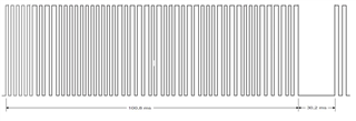

using CC112x for years now in FSK, I wonder why we don't use them outside FSK - we manufacture some thousand (legacy) OOK systems at 868Mhz per year; typical application are keyfob systems.
We can't change the protocols of these systems due to backward compatibility; a typical protocol timing is attached!
Today we use good-old TDA receiver chips and I asked my engineers, why they don't use our main RF chip CC11xx.
Reply was 'because you can't use them in ASK transprarent mode':
1. first they obviously can't deal with the long pause in between packet repetitions (we had the same issue with FSK, where at least we tuned the AFC as long as it fits. This doesn't work in ASK, as they told me).
2. then if they tried to use it with much shorter pauses, the sensivity was 20dB worse than with the TDAs
Can you advise if this is correct / how we could use CC's in that field?
thx

  • Diego, thx. a lot for support,
    the payload is for backward compatibility strange & plain:
    user press a key and TX starts to send simple data packets without any sync/CRC/whatever. Packets are repeated after a max 32ms pause minimum once, sometimes just 'forever' if key remains pressed.
    Coding is done in ancient 1/3 - 2/3 procedure: for example a '0' is represented by (1ms ON" plus 2ms "off"). A "1" means (2ms "ON" and 1ms "OFF") - so there is a return-to-zero every bit.
    Hope that give some some light on the subject.

  • Hi Gerhard,
    Thank you for the information. What is the exact issue they get after the "long" pause?
  • For OOK it's tricky to know for the receiver to know what to see as a logic '1' and logic '0', especially without preamble and sync. I suspect that the modem keeps track of that using a IIR filter and setting the threshold with the difference between '1 and '0'. If you receive one the one or the other, the threshold will move and at the end it will not be possible to distinguish between '1' and '0'.
  • The issue they observe is very typical to what he had with FSK transparent mode on these long pauses:
    in FSK CC1120 assumes a long pause as new 'mid average carrier freq' and, due to AFC, it shifts mid carrier freq accordingly. Then, when that pause ends, the first bits of the new packet are screwed or it sees bits where they aren't close to the end of a pause. Setting AFC to be much more relaxed helped us out.
    Same happens here: first bits of the new repeated packet are screwed. But there is no AFC we could tune in OOK...
    It's obvious that a sync/preamble would be helpful, but those ancient protocols doesn't have that: typically TX was a stupid logic devices, acting as 'map 4 keys to a shift register and send it that serial out'. Sure today we would use paket mode if we start someting new, but there are thousands of systems out there with receivers which expect this ancient protocol.
