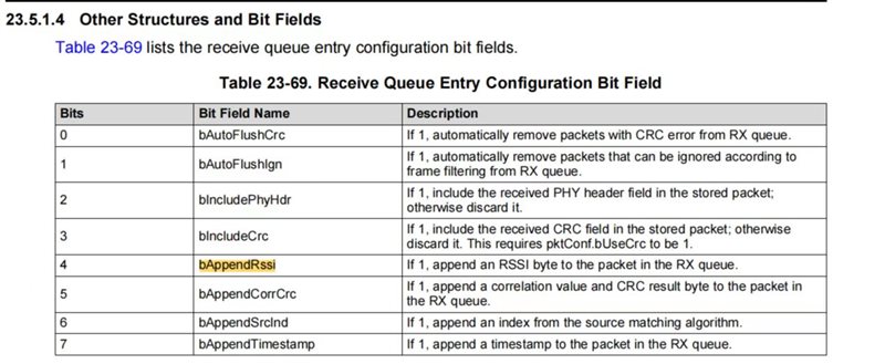

Test environment: The customer uses his own board, uses the RF studio transceiver automatic test function, sets the RF parameters such as the transmit power, exports the. C and. H configuration files, loads them into his own CCS project, compiles them and downloads them to his own board.
After reading the RSSI value, it is found that the RSSI value in the original message received by the customer is inconsistent with the one read by RF Studio, and the difference is about 15dBm each time.
1. Can you help me analyze the reason? I think it is caused by the customer's own software, but the RF configuration used is the same as that of RFstudio, so I don't know how to solve this problem, thank you.
2. Can RFstudio save the original packet receiving RSSI to analyze the correspondence between the RSSI value on the interface and the actual data frame? Can you explain the data source of the RSSI value in RF studio?
