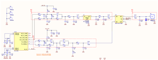

    - The CC1352P and CC1350 are not pin compatible meaning that you can't use the same PCB for both. Also the fact that changing the chip changes the performance is a bit strange. Would you be able to post a screenshot of the RF part of the schematic/ layout to get a better idea?
    - Could you share how you are measuring RSSI in your FW?
  • Good morning,
    Yes, they are not pin to pin compatible. I meant that those two PCB’s are identical except the part where RF transceiver is fitted. RF shielded section, containing RF transceiver is different but elsewhere the board is identical.
    Schematic
    PCB
    RSSI code

  • At first I suspected a HW issue but now I think you have a SW issue. I haven't looked at the timing here but I suspect that you in some cases are reading out RSSI when not in RX. It's possible to set a DIO high when the radio is in RX, I would do that and at the same time set a DIO just before/ after using getRSSI.
    For packets it's easier, the RSSI of the last received packet can be appended to the receive buffer. Have you looked through https://dev.ti.com/tirex/content/simplelink_cc13xx_cc26xx_sdk_6_40_00_13/docs/proprietary-rf/proprietary-rf-users-guide/proprietary-rf-guide/index-cc13xx_cc26xx.html ?
  • Sorry for being away for few days. First of all, thank you for your time and effort, really appreciate it. Good to know that we always have people to consult with. Here are results of suggested investigation:
