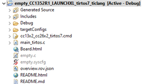

    I did the following>
    1. Imported drivers/empty project from the SDK and I excluded the empty.c and empty.syscfg from build.
    The corresponding change could be seen in the .cproject file as you rightly mention.

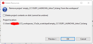

    2. I deleted the project from the workspace without deleting project contents on disk.

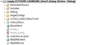

    3. I imported the deleted project back into CCS.
    4. I see that the exclude from build is persistent.
