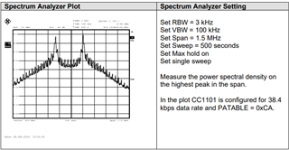

when we are performing FCC test with CC1200 module, for PSD test we are not able to achieve require power level.
when we are increasing bandwidth from 100kHz to 3 kHz, power level is coming above 8dBm.
please tell me on how to achieve this scenario.
