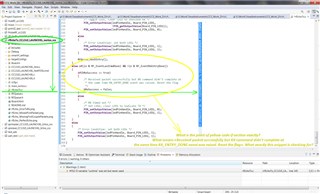

Q1: I'm studying the example "rfEchoTx_CC1310_LAUNCHXL_nortos_ccs", So I can't understand the point of one "if-snippent" in the example - it is on the picture attached to this letter.

  • Hi Siri,
    My apology for that. below is the image
    Josel
  • In the example, the TX command is chained with an RX command.
    The TX command will always run and result in a RF_EventCmdDone interrupt.
    The RX command can generate 3 different interrupts:
    • RF_EventCmdDone
    • RF_EventLastCmdDone
    • RF_EventRxEntryDone
    1 and 2 will always happen, while 3 will only happen if a packet is received.
    Assume you get the callback and RF_EventRxEntryDone is asserted (packet is received). The code will then set bRxSuccess = true; set the proper LEDs and return (will not check the next else if)
    You will then have the callback again when RX is finished (RF_EventRxEntryDone).
    the RF_EventRxEntryDone is already cleared on the previous interrupt, so the
    else if((e & RF_EventLastCmdDone) && !(e & RF_EventRxEntryDone)) is true.
    It is not necessary to figure out if a packet was actually received (bRxSuccess) or if the RF_EventRxEntryDone never happened and the RF_EventLastCmdDone happened due to a timeout.
