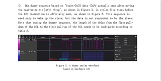

There is an iIC device that supports 400 KHz communication speed. There is a requirement for timing that the start bit SDA of the transmission is 5US before SCL is pulled low as the CC1310 is only 1.5US, is there any way to let the iIC of CC1310 transmit data by pulling sda low by 3.5us before sending the start bit normally?
To communicate with the hardware iIC, it is discovered that in 400 KHz mode, the slave device has timing requirements. The start bit SDA is pulled down 5US first your company's chip only pulled down 1.5US before the end of the day, so you asked this question
