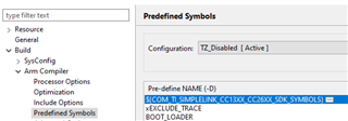

    For logging, you need to disable the EXCLUDE_TRACE symbol, by for instance appending "x" to it in the project settings:

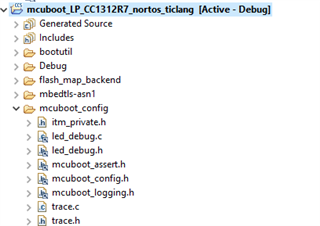

    After that, you need to copy the itm_private.h, trace.c and trace.h files from SDK_PATH\source\third_party\mcuboot\boot\ti\source\mcuboot_app\mcuboot_config to the mcuboot_config folder of the mcuboot_app project.

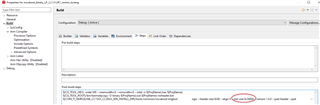

    and in the post-process steps of the blink project I changed the  step:
    sign --header-size 0x80 --align 4 --slot-size 0x56000 --version 1.0.0 --pad-header --pad  to
    sign --header-size 0x80 --align 4 --slot-size 0x55000 --version 1.0.0 --pad-header --pad

  • Hi Javier,
    Given that you have updated the slot size, you also need to update the imgtool post build command in the post build steps of the mcuboot_blinky project:
    So in your case, it will most likely be 0x55000
    Arthur
  • Already done as said in the previous post.
