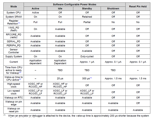

    According to SWRA486 document
    In standby mode, Current is about 1uA.
    But my module' avg. current is 400uA.

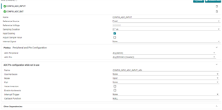

    It sounds like your configuration is affecting the power consumption even when the ADC is not in use?
    Can you check SysConfig -> TI DRIVERS -> ADC -> PinMux and check the configuration when pin not in use? I would recommend input, no pull.
    Cheers,
    Marie H
    Yes right. configuration is affecting the power conmsumption.
    Follow image is ADC config. I set.

    I did power consumption test by setting config. only.
    There is no ADC function on my code at all.
    I did test on the CC1312R DK board.
    Same result.
    After just adding ADC in sys config., current is about 70uA in standby state.
    After remove ADC function from config, current is about >1 uA.
    BR
    Paul
  • Hi Paul,
    The current consumption you are seeing is due to the ADC pin being left floating when not in use.
    In SysConfig, you can avoid that by pulling the pin up, or down when not in use:
    Arthur
  • Hi, Arthur,
    Thanks.
    After set ADC pin to pull down, current consumption goes down to expected value.
    BR
