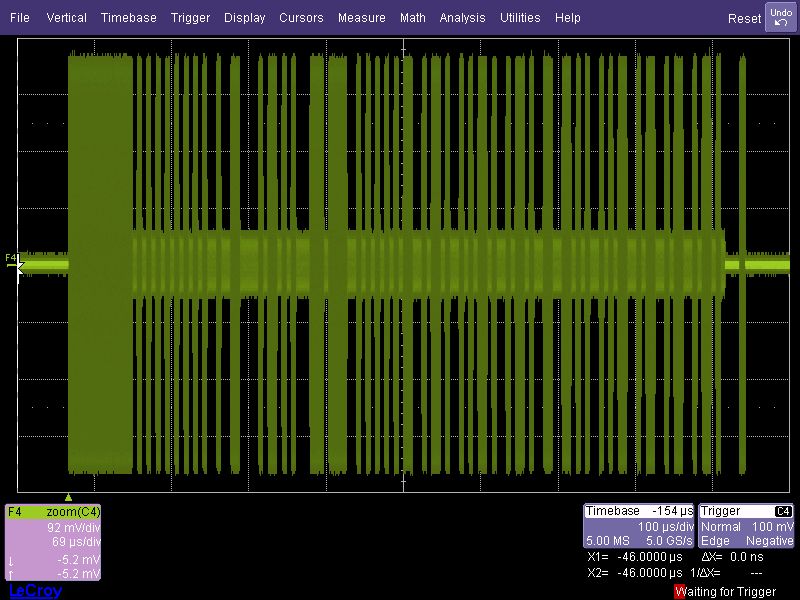

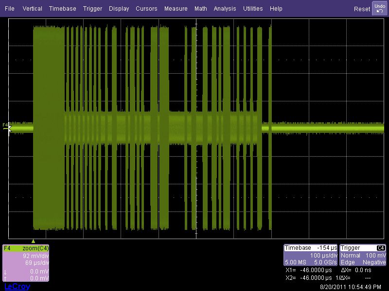

  • So after looking at the data from the CC1120, the result is that Siri and TER are correct in that the preamble and sync are not Manchester encoded but all the rest of the packet is including the CRC word if appended to the packet.  This actually makes sense considering the CC1120 uses a matched filter design to detect the sync word which would not be capable of being implemented if doing it after Manchester decoding as is done on the CC1101.  The CC1101 uses more traditional data synchronization and detection mechanisms which allows for the entirety of the packet (including sync and preamble) to be Manchester encoded.
    The good news is that the CC1120 has several preamble selection options which will allow the CC1120 to communicate with the CC1101 when Manchester encoding is used.  Note that you will need to pick a sync word that is valid for a Manchester encoding, i.e. only 5, 6, 9, and A values in the hex representation of the sync word.  You will also have to pick a sync work on the CC1120 that is twice as long as that used by the CC1101.
    I would suspect the issues with the CC1020 are similar as this part is more vintage than the CC1101, but  that's just a guess.  I don't have a CC1020 to look at to verify but changing the preamble and the sync word should be all you need to experiment with to figure out which is correct.

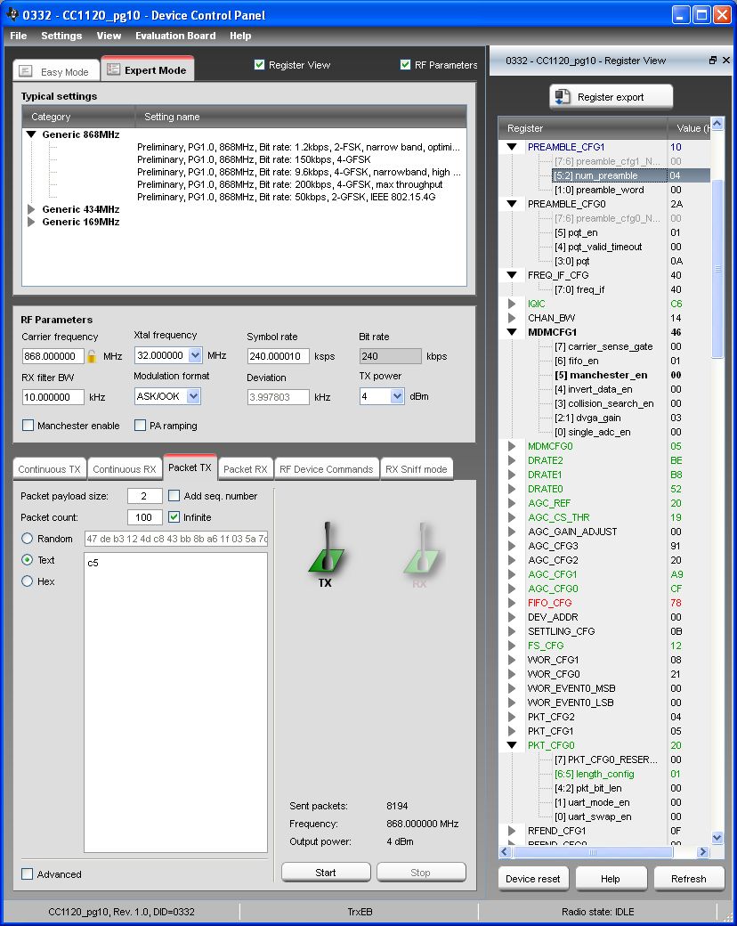

                     Experimental Results
    Here is a screen shot of the CC1120 SmartRF Studio setup
    Here is a screen shot of the scope with Manchester encoding enabled
    Here is a screen shot of the scope without Manchester encoding enabled
    Here is the envelop detection with the bit stream for reference.  Note that only the preamble and sync word are not Manchester encoded.  The length byte, payload data, and CRC are all Manchester encoded.  Also, note that the data was properly normalized (in time) in the payload region for comparison.  It is not valid to think of both data streams to appear superimposed this way on the scope.
