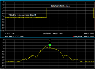

I want to print continuous data using CC1312. But I couldn't get exactly the results I wanted. The total transmit time takes 2.25ms (for 255 bytes). But after every 255bytes, TX shuts down. And the reopening time is about 175us.
1) Is this the RX/TX switching time of CC1312?
2) If so, can I use CC1312 only in transmit mode? What I mean is clearly visible in the spectrum image I shared below.
n the spectrum image below, the transmitted signal seems to completely close the TX chain at the end of 255 bytes (-60dbm is the lowest point). The only thing that comes to my mind is the switching time of CC1312.
NOTES: I will never use Receive in my application.
