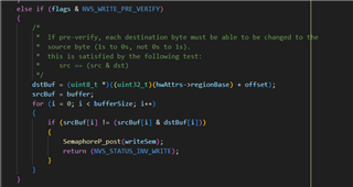

    The NVS write does not read the Flash content before writing. The source of the driver can be found here: [SDK PATH]\source\ti\drivers\nvs\NVSCC26XX.c
    There is a pre-verify flag, which is used to ensure the data is actually writeable without needing an erase. But this still is not what you are asking for.
    You would need to handle it in the application if you need to read before writing the string.

  • Hi Zhiyong,
    If you debug the code, can you please see why the logic is failing? Is it because of wrong management of "offset" by the driver?
    Sid
