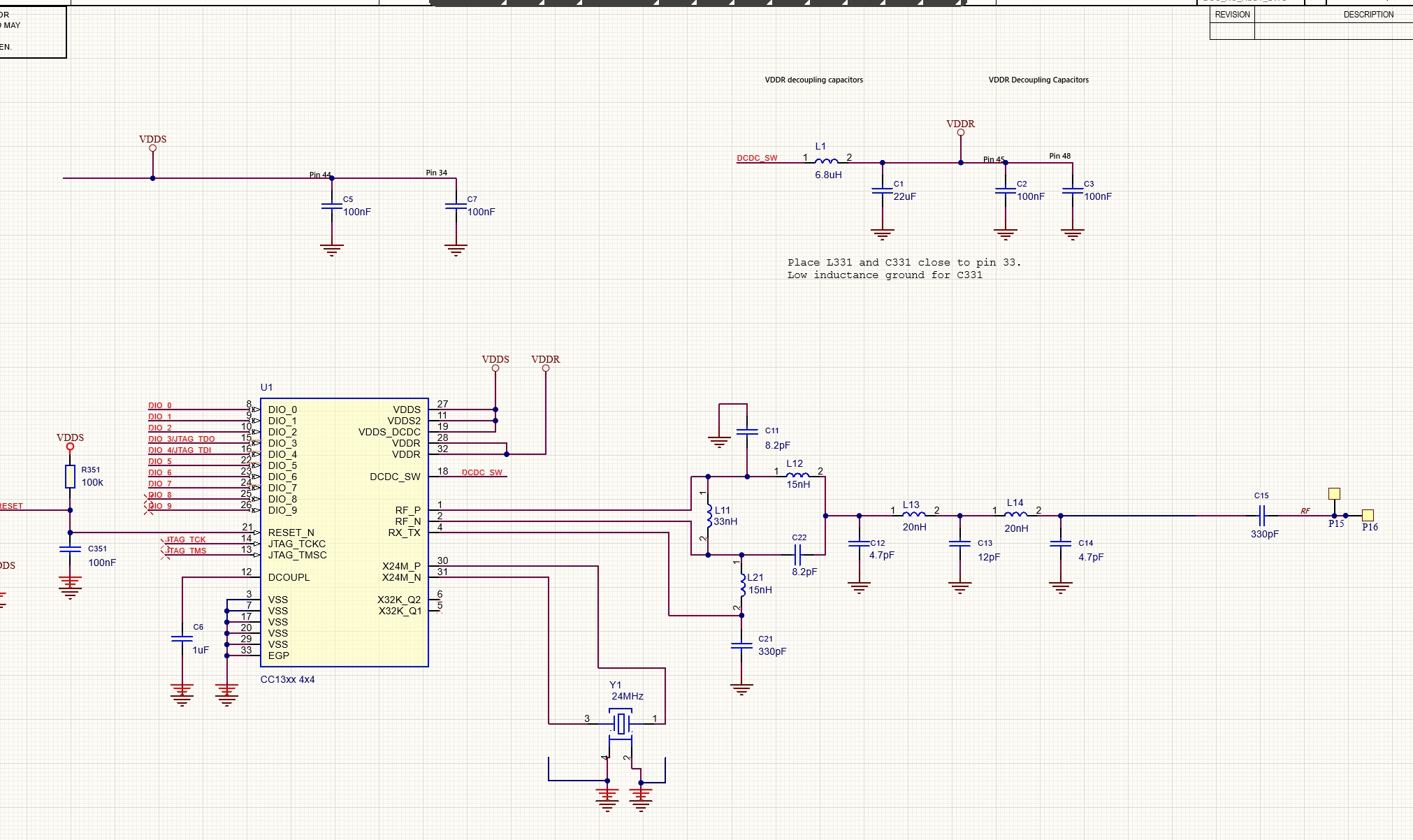

CC1310: I tried to reduce the size of the CC1310 related design, but the RF performance(433MHz) was not as good as expected. What can be improved?
Part Number: CC1310

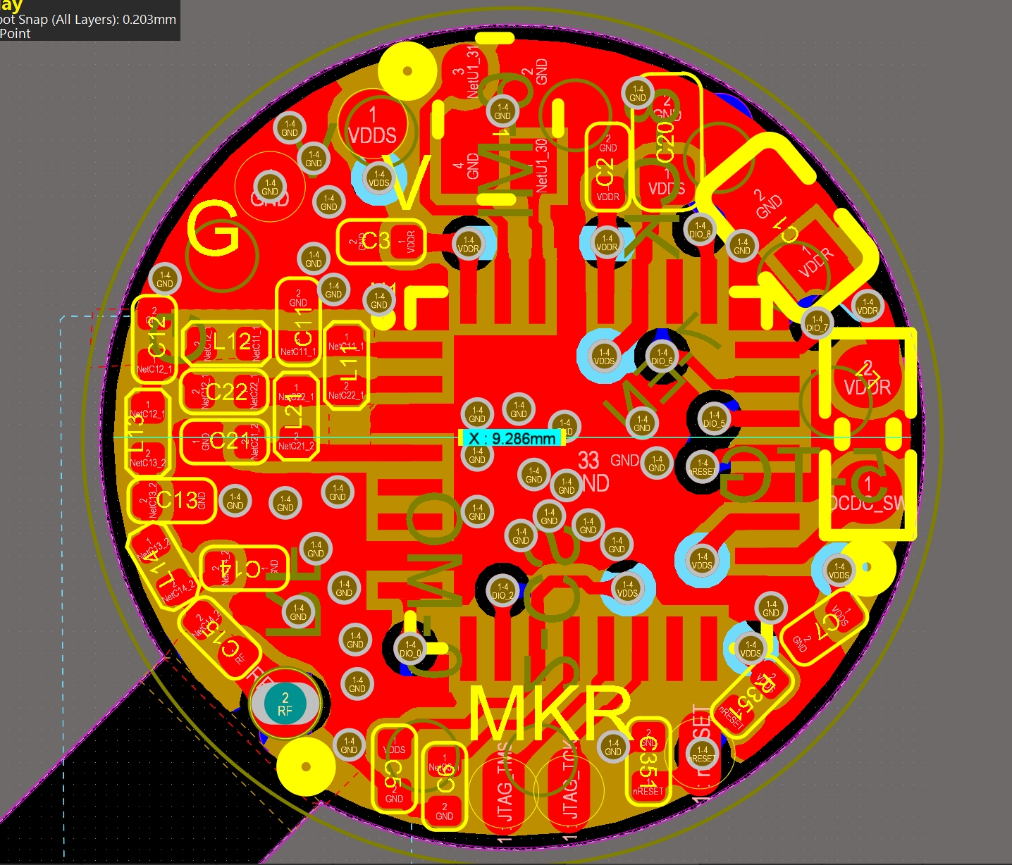

This is my schematic design and PCB design.

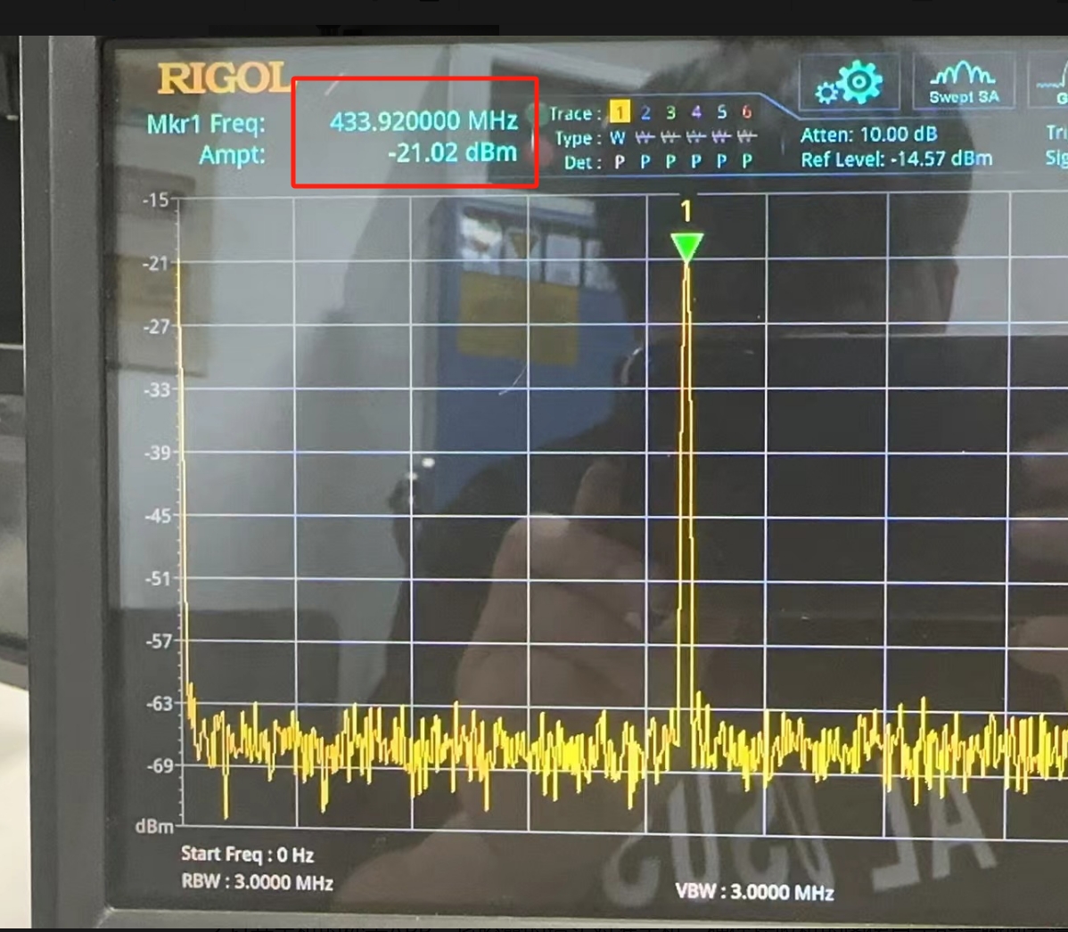

When the software sets the RF power to 4dmb, the actual signal strength measured using a spectrum analyzer is only -20dbm.
Where can I improve my design?

  • Hi A B,
    I noticed you don't have the 22uF capacitor on VDDS_DCDC in your schematic and a 100nF cap is missing. There should be a 100nF cap for each VDDS pin. Were this component intentionally left out?
    I see you don't have an RF connector on your board. How exactly are you measuring the output power? Are you soldering a semi rigid cable?
    Are you using Smart RF studio to set the device to continuous Tx or how are you transmitting the carrier wave?
