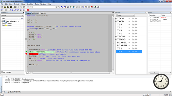

  • hec said:
    Third, when you switch oscillators, I recommend that you wait for the clock switch to complete.
    I put a breakpoint immediately after  while (CLKCONSTA != 0x38); However, even after 4-5 minutes of execution, the code never broke out of the loop. Please help.
    John
  • The switch should happen in less than 500 us. What is the value of CLKCONSTA when you break?
    Note that this statement tries to switch to the 32 KHz XOSC, and this can only be done while the system is running on the 16 MHz RCOSC. If you do this clock switch right out of reset, it should work, but if you have already switched to the 32 MHz XOSC, but not the 32 kHz XOSC, you need to modify the instructions. If you don't want to use the 32 kHz XOSC, you can write CLKCONCMD = 0xB; and while (CLKCONSTA != 0xB8); instead. If you want to use the 32 kHz XOSC, you should enable it in the first clock switch operation after reset.
    The value is 0. The screenshot shows the condition on break.

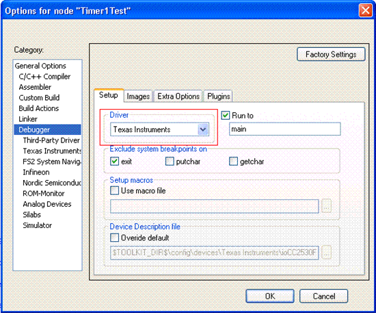

  • Are you sure that you are running on the target and not using the IAR simulator? The simulator does not support hardware register simulation. Under Project->Options, go into Debugger and make sure Texas Instruments is selected under Driver:
  • That was it! I was using the simulator indeed.
