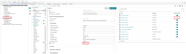

    If you want to send a packet with 12 x 0x7F + payload this can be achieved in the following way:
    The preamble is configurable with an override, so after using sysConfig to generate you settings, you need to add the ti_radio_config .c file manually to your project, and exclude the SysConfig generated file from the build.
    In the ti_radio_config.c file, change the following:

    With these settings, you will send 4 bytes of 0x7F as preamble, 4 bytes of 0x7F as sync word, and then you have to add the last 4 bytes of 0x7F, as the 4 first byte of your packet.
