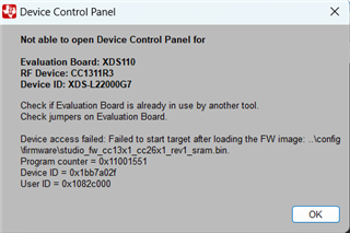

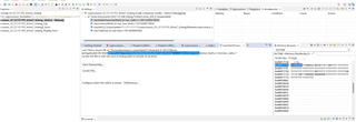

My customer is running TI15.4 coprocessor example from simplelink_cc13xx_cc26xx_sdk_7_41_00_17 on their custom CC1311R3 board, the board is able to be flashed through Uniflash and CCS, and connect to an XDS110 debugger to run the TI15.4 project. However, the software will be stuck on macRadioPowerUpWait after the software is running:
When trying to connect to SmartRF Studio with the board, SmartRF Studio has an error "Failed to start target after loading the FW image:...":
I suspect the hardware has some issues which makes the RF failed to be initialized, but not sure about the exact reason. What could be the cause of macRadioPowerUpWait to be stuck?
